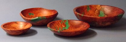

The above bowls came from a west Texas mesquite burl that had been setting for several years before it was brought to me to make something of it. The worms that attack mesquite as I understand do not give up on a piece just because it is dry so getting some thing to give for the burl was quite difficult.
The method I used was to fill the voids with epoxy putty the turn that down till it was part of the surface then under cut about 1/16' and refill with powered turquoise, then finish that off a consistent surface. The bonus for me was a ride in his Stearman biplane.
