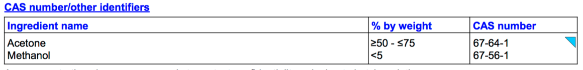

Have been a fan of Minwax hardener which is about one quarter plastic, the rest acetone with about 5 percent methanol (for whatever that does). So expensive. Have not tried yet the shellac and acetone mix advised here. I did try to dilute polyurethane with acetone but the penetration of anything but the solvent was a failure.

Plexiglass shavings melted in acetone overnight seems a great idea (if I can just find some plexiglass in a remote coastal town). Close to the Minwax hardener. They mix about a quarter plastic with the rest acetone and 5 percent methanol.
