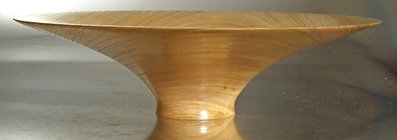

Picked this bowl Blank up somewhere, I.d. Needed, please.

Here is the finished bowl if that helps...
First pic almost looks like Osage Orange. Deep Amber color will darken with sunlight (and time/months) to more brownish/amber. Catalpa that I've turned has a more greenish hue, but second and third photos remind me somewhat of Catalpa. Photo lighting can be deceiving. Bowl looks great in any case.

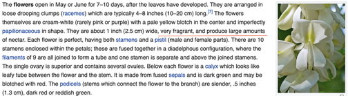

Reed maybe you do not have a Black Locust, maybe an Acacia tree ??
The sweet smell from a tree loaded with the trusses of flowers is almost overpowering, see this Picture and the load of flowers it can have, closeup of the flowers also with info.

Reed, Black Locust over here has a quite different Bark and the wood is also different, yes Ailanthus is not a hard wood, but harder than Catalpa and it turns nicely, and yes Black Locust is pretty hard for sure, but still turns and finishes well for me
View attachment 38666 View attachment 38667 The flowers smell very nice, almost too much from close by.
That's exactly what black locust bark in the southeast US looks like-smells too. LOL
