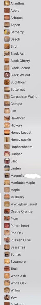

I have turned quite a lotto different species, and some were smelly while wet turned, but there isn't a single one of these that smelled later after they had dried, even when cut later there is often no or a very faint smell, as a matter of fact I just drilled and turned a small piece of Juniper (aka Eastern Red Cedar) and I could barely smell it while working it.
Here is a list of most of the species I have turned over the years, there are a few more, like Afcelia and Afrormosia, Bloodwood, and some pieces of Rosewoods, but they would be just some small pieces.

That’s a great list Leo! When I have folks come to look at my work they’re often surprised when I can quickly tell them not only the species, but where the specific tree was located. I had a woman come last night who bought three bowls from me to give as gifts. She was particularly thrilled when I told her one was from a home a block away from her. She said she’d keep that one for herself.
