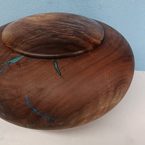

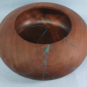

I only used Odie’s oil once on a walnut crotch hollow form which was posted here in January.
This is a photo I took today, 8 months later. I think it darkened it over the last 8 months and I lost detail. I am really not happy with the results.
IView attachment 46051
Which odies oil did you use? Was it the universal?
