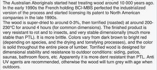

@Leo Van Der Loo
Thanks for the information, Leo. It’s helpful. Also interesting to read about the comparison with PTL.
That bowl is beautiful as well! It’s a nice combination of the forum buzz lately, haha—wedges, stripes, and roasted wood.
