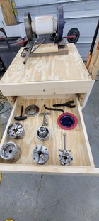

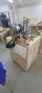

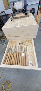

IMG_0651.jpegIMG_0636.jpegIMG_0637.jpegIMG_0652.jpegI used to have my turning tools on the wall but they kept collecting chips and I had to clean it all the time. When I moved into my new shop I was able to turn my lathe and I built a cart with drawers to hold everything. I have my go to tools on the side in pvc pipe. When I am turning something that requires rare tools I take them out of the drawer and set them on top, then put them back when done.
