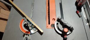

I do have one question for you, though. You say an Incra miter gauge won't work with the Miterset Segments you linked. Why is that? I have two, one that came with my table saw, and the Incra. As far as I can tell, they both seem to have the same fundamental design. What exactly is it about the Incra, that would prevent me from using the Miterset Segments?
Here are my two guauges:
Your Incra looks different than mine. Mine has discs on both sides of the bar to adjust for fit. The miter gauge must be registered against the same side of the miter slot in the table saw and the Miterset. The discs on my Incra are too far apart to register in the short slot on the Miterset. As long as your miter gauge has one straight side with no screws or discs protruding on the side it should work. When using it you just need to make sure you register the proper side against the jig.
