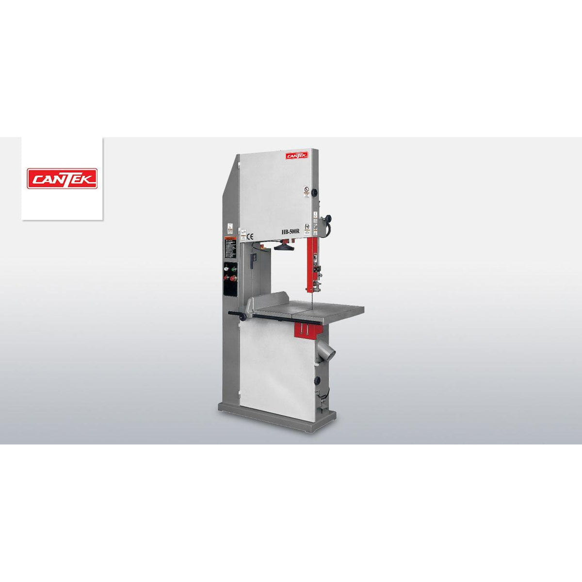

Is 7.5hp enough? And the blade is 19' long. Rockler probably doesn't stock those blades...
Other bandsaws at this site, catering to industrial users. That said, some prices are on par with prices some turners here pay for lathes.
$4500 will get you 3hp with a 20" wheel. And this is the small model from this manufacturer.

If I were in the market, I would find this one hard to pass on.
