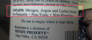

From a winery visit, I once bought a can of Bloxygen that was relabeled for winery sale. It was either straight argon, or the argon/CO2/nitrogen bend.
Bloxygen has gone to pure argon, heavier than air, works well with finishes.
They market the same product to the food and wine industry, different label.
The old Bloxygen from years ago used an argon, nitrogen, and carbon dioxide mix as per the label on a can on my shelf. They told me they discovered the CO2 could react with certain substances so they eliminated it. And Nitrogen is lighter than Oxygen so if you didn't displace the air it could leave a layer of oxygen at the finish surface. Pure Argon was found to be the best choice - even if the air wasn't totally displaced the Argon would settle and protect the finish.
