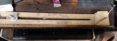

I was cleaning off my workbench this evening and I found my original homemade wolverine platform. You could use this with the Varigrind or a homemade Ellsworth jig.

I was cleaning off my work bench this evening and I found my original homemade wolverine platform. You could use this with the Verigrind or a home made Ellsworth jig.

Thank you so much. First I was thinking in doing my own but since I have to buy a tool rest I saw that the basic Wolverine comes with the tool rest and platform.
