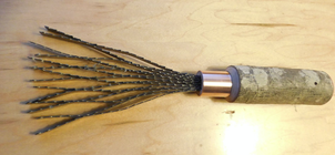

Buffing rake from an old bandsaw blade. Looks grabby but it's not.
A good buffing post from 2017.
Ps. Never did make a longer handle :D

A lot of suggestions for steel based tools for cleaning the buffing wheels. The Beall directions now specifically state that using steel based abrasive tool discolor the wheel and rendered it unusable for wood buffing. Now, I've never used a steel based tool for removing any buildup on the Beall wheels, I'm wondering if anybody can confirm that steel based tools do, in fact, ruin the wheels for buffing wood?????
Originally, I used a coarse sandpaper, as in the original Beall directions......but, changed over to a brass bristled brush.....and since it worked well, stayed with that solution. I never did I use a steel based brush, band/circular saw blades, galvanized nail plate.....so, I can't confirm the warnings from Beall against that.

@odie Been using an old steel wire brush with no coloring of the buff wheel. It was old and rusty, and it was cleaned with a brush wheel, then dribbled some dna to wash off residue. Very lite touch is all that is needed. I use it to break in new buffs and clean some I overloaded with compound. I clean it with dna and air after cleaning a buff.

Just looked at it on Beall's website. $12 is a reasonable price, but shipping was another $12 ... I'll just use a board like John Lucas!
