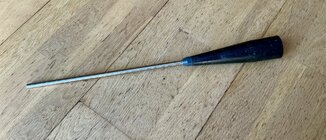

View attachment 71739Mine is just a quickly turned wooden adapter that fits the standard shop vac hose and has a piece of 1/2 PEX plastic pipe hot glued into it. The PEX is a little too long and I keep forgetting to cut it off.
That looks good for dust. Do those long small nozzles get clogged up with chips?
