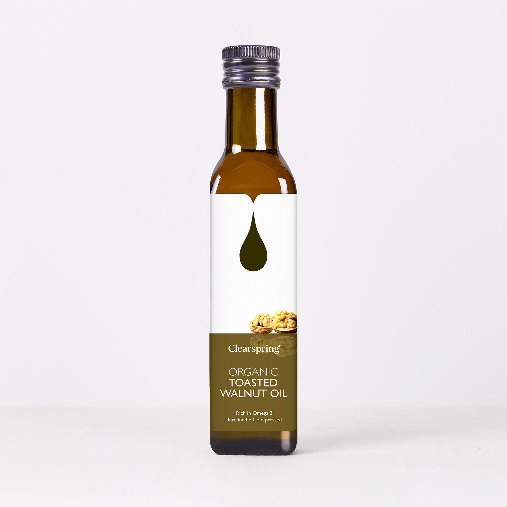

I can’t be sure but most of the Walnut Oil sold here in UK supermarkets seems to be Cold Pressed, Unrefined so I’m expecting it’s just pure oil without any heat treatment?
Never having shopped in a British market, I can't say. The one I used says "Roasted Walnut Oil" prominently on the label, but comes from California.
I believe the walnuts are roasted, then the oil is extracted. Vs. the other way around... I don't think I'd use grocery store oils of any kind for a finish. They would have proteins in them, which can effectively rot over time. The lipids in the oils can go rancid themselves over time, and I suspect to some degree or another that does happen even with pure walnut oil. However when the lipids polymerize as they do in the wood when used as a finish, those polymers become resilient to further oxidation and won't go rancid thereafter. If you impregnate walnut proteins into your finished products, though, I'm pretty sure those proteins are going to break down over time, which is effectively rotting...
