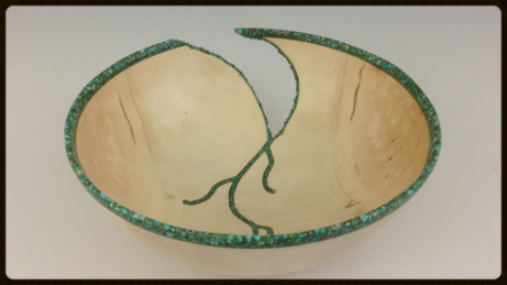

Larry Fox (Foxy Woodz), here in Colorado, made a how-to DVD on the outlay process about 12-15 years ago. Don't know if he still sells the video. Click here for contact info. Also check with your local AAW chapter to see if they have Larry's DVD in their lending library.
It's really a pretty simple idea:
- Turn dry wood into a rough bowl shape, with about 1/2" wall thickness
- Then cut a grove (inlay) into the lip of the bowl, at the same angle as the bowl's shape, about 1/8" to 1/4" wide and equally deep
- Remove the bowl from the lathe and fill the grove with your epoxy and crusted stone, Inlace, glitter (whatever) mix, making a "inlay"
- After the fill is completely setup, remount the bowl on your lathe and finish the turning, making the wall thickness equal to, or less than, the width of the filled grove, thus exposing the outside edges, and turning the inlay into a "outlay"
- If you are concerned that the wood may move a little during the curing process, making the rough-turned bowl out-of-round, make the inlay grove a little wider so you'll have more material to remove during the finish outlay cuts/sanding

@ Ed: Thanks very much for the tutorial.
As for the nearest AAW chapter, I live about 3.300 miles east of West Quoddy Head so I'll have to make do without the video.
