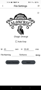

I saw the previews in some of the you tube videos. Haven't found it yet in my limited use so far.
Update, I can't find a preview or centering in the software. Do you guys have the next model up or something?
When I initially downloaded the app I got a message that the version wouldn't run with my version of Android which I guess is the latest. I switched to an older phone and it did download but I didn't have the laser yet.
When the laser came I went ahead and installed the app on my current phone but there isn't anywhere I finde to project a centering dot or have it display a box outline of the cutting area. I'm going to try using my older phone now to see if that will open up those options.
another update
Switched to an older phone and I get the outline of cutting area and a centering dot....that's a game changer. made me a whole lot happier with it.
It must have knocked something loose so to speak software wise because I switched back to my newer phone and was able to get center dot with it now. So all I have to worry about is the 200mm distance. much easier.

another update
Glad it is working better. I probably need a firmware update cause when I select show center point I get the box shifted with a corner at center instead of a dot. Have fun playing with it! Don't shoot your eye out.
It's still being glitchy. I'll get the square box and can't get the center point sometimes till I back up a page and try again. Other times I'm not sure what I do to get to where it will preview. I went to try the old phone with a image of a logo and it doesn't want to sync with my desktop like the newer phone will.
First world problems I know.....

I forgot about that preview bug. I just back out of preview and then go back to it.
I'm using LP software on my Android phone and don't get that message.
Do you not have the Start Preview button?
