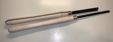

Top is a handle made using methods similar to robo hippy's for a square tang'd tool -- I had watched his video ... (bottom just a regular handle...)
