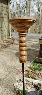

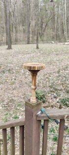

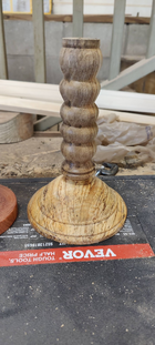

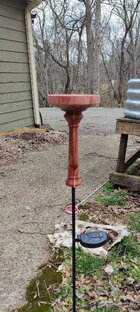

I think it's the aging effect. This prototype was made from two pieces of persimmon from the same tree. The top (which is at the bottom in this picture) came from a section that I had set out to spalt. The bottom spindle came from the top section of the same tree that was laying on the ground just 100 ft from the spalted log. Same tree, both just sitting on the ground, but the spindle is much darker. BTW, since this was a prototype I didn't bother measuring the beads, as you can tell.
Does anyone want to guess what these are? Like I said, prototypes, so they are rough. Persimmon, white oak, and cedar. Apologies for the cedar one being out of focus.
IMG_20260305_124036 (1).jpgIMG_20260307_133911 (1).jpgIMG_20260303_120417.jpg
View attachment 86264View attachment 86265View attachment 86267
Meat tenderizers?

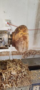

Turned this one yesterday 1/8” thick and it measured 13-3/4” x 10-3/4”. Looked at it today while turning some other bowls and thought looked like it had moved some. I measured it and it measured 11-1/2” x 10-1/2”, one side moved more than the other. First picture shows how much it moved.
I’m not really a fan of that much warp. I may wet it and put a couple rubber bands on it and see if I can even it out.
