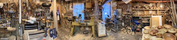

Well just got a chance today to take a couple shots of the lathe station. This area is dynamic but the rest of the shop is more or less static.
lathe 2 2021.jpglathe 2021.jpg2.bowls-carving 8-19.JPG4.over TS bench-back wall 8-19.JPG6.wood to BS 8-19.JPG8.DPto router8-19.JPG

here's my shop shortly after we finished building and setup for a studio tour weekend here on the island...the other photos are of the turning area as it is most of the time. Haven't had a studio tour weekend since covid hit. Looking for a good excuse to clean up.

Here is my shop all cleaned up. It is a round adobe structure. Having round walls does create some challenges. It has been inproved/modified over 30 years now.
