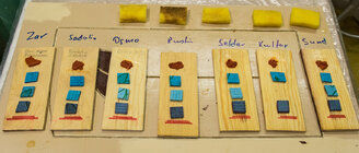

Concerning durability I did a test, there are several on Youtube. This is a comparison I did. Applied 3 coats with drying over night. Final drying one week.
Top to bottom Ajvar relish, water, whisky, red wine, permanent ink marker. Covered with plastic foil over night. Wiped clean next day, denatured alcohol to remove permanent ink marker.
Zar - waterborne polyurethane
Sadolin - waterborne acrylic
Osmo - Osmo 3032
Rustin - Rustin´s Danish oil
Selder - Boiled linseed oil
Kultur - boiled linseed oil
Sund - raw linseed oil
