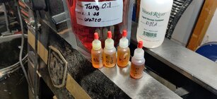

Here are a couple photos. The BLO, is proibably over 2.5 years old. The Danish Oil (natural) about two or so. The Tung I picked up at the very end of last year and bagged it new years day. :D
You can see what happened with the DO bottles more closely here:
This one was the worst of the lot. I think it was the last bottle I filled, and wasn't completely full. So it had more oxygen in there... But, looking at it, it doesn't seem as though the oil pulled up into the cap at all. So maybe there is something else going on here, not related to oxygen... The one I added turpentien to, has some chunks from the cap that I thought I might try to dissolve (nope!)
