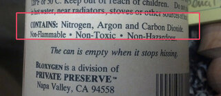

I've written about this too: at one time the gas in a Bloxygen can was a mixture of Nitrogen, Argon, and CO2.
At some point they switched to pure Argon. At the time they said they discovered that the CO2 could react with chemicals in certain finishes. I think they went to Argon since it's heavier that Nitrogen and even if the air in the can wasn't completely displaced, a layer of Argon could settle inside the can and still protect the finish. Years ago I had people point out I shouldn't use Nitrogen since it is lighter than air - not a real problem for me since I completely displace the air in the can. This was handy for me since I used that tank of Nitrogen for lots of things besides finishes and it was about empty. So I switched to a spare tank of Argon.
