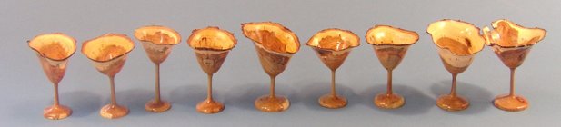

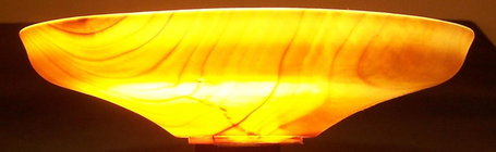

Two guys come to mind -
Pascal Oudet - turn super thin endgrain oak relying on the rays to hold it together
Also many other shapes. Uses light.
Johannes Michelson - thin hats uses a light to judge the thickness - a useful technique on woods that pass light.
I use it on goblet cups, little vases etc.

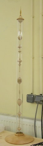

If you Google "Trembleur" you will find links "most are French I think" anyway they do the thin turning competitions that are amazing IMO.
Using a bedan for accuracy plus other tools, they have to use string steadies as the figures are too heavy for the 1.8 mm stems (max) to carrie.
Official length is 1200 mm and are usually too flexible to set upright, suspending is possible.
