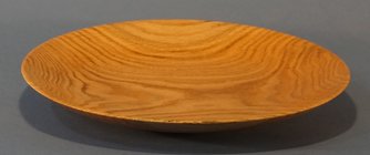

22070Bowl.JPG This red oak bowl was made from a 2" plank without a tenon using a wood worm screw into what would become the inside of the bowl. The entire bottom of the bowl including a recess was completed on the wood worm. The bowl was then mounted on the recess and the inside finished, simple no muss on fuss.
