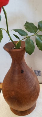

Your Mr. "Vazier" app looks pretty cool .. hats off to you and Marie !! Turned out to be very nice vase. One of the things I've done when turning bud vases is to bore a 3/4" hole down the neck with a little recess at the top to accept a glass test tube ... just a thought.

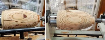

I was pretty confident the glue joints would hold; those curved miters would be near impossible to shear. But I was still a bit worried about the LVL. It was full of voids and knots. I made sure to wear my ā€œspace helmetā€ while turning.
Since the 3d model for the staves ended at the outer edge of the curved miters, I knew that turning down to the glue joint would make the shape exactly what I designed in Vazier. Also the wall thickness would be exactly what I specified. No need to worry about turning through the wall, even though I couldn’t see or feel inside!
The LVL turned surprisingly well, especially after I got the corners knocked off and cranked up the speed. It only took about 10 minutes to get to the first picture below, close to the glue joints but not quite there. At that point I switched from roughing to nice gentle shear cuts. Another few minutes and I was at the glue. Whew!
