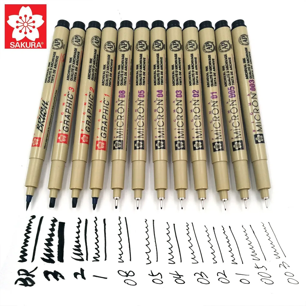

The pack of 4 Sakura pens I purchased were sepia/black, 005 and 003. I intended to write the inventory number very small with these. We'll see how my next experiment with doing the inventory number on bare wood. (After turning the foot, and then waiting to apply the DO after waiting 24hrs.)
Sakura-12-Tip-Sizes-Micron-Neelde-Drawing-Pen-Fine-Lines-Black-Sketch-Marker-Pen-for-Design.jpg
Thanks Mark, for giving me incentive to keep trying! :)
I usually turn the foot, and apply the Danish Oil right away. Maybe if I used the Sakura pen on bare wood at that point, and wait until the next day to apply the finish would work. I'll give that a try the next time I turn a foot. It's possible that giving the ink more drying time, and applying the Danish Oil over the top, might be a little more durable......and, hopefully will withstand the buffing process. With a little practice, maybe I can still make it work.....we'll see!

I ended up getting this assortment in 03. I didn't see the assortment in 02, but it was also available in 01. When I purchased the pens I have in 003 and 005, I didn't know how small they actually were.....and, they were way too small. Based on this knowledge, it's why I went with 03 for this purchase. Hopefully, the larger size will enable me to overcome the problems I was having with my writing skills......maybe!
The colors are 2ea black, and 1ea of blue, green, red and blue/black. Any of the blue, green and red ought to show up on dark woods.....we'll see about that.
