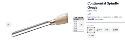

A 1 1/4 tool is likely to be 30mm or sometimes 31mm and both are smaller than 1.25 inches
English bowl gouges are 1/8” less than the bar diameter.
Spindle gouges are the bar diameter.
Two 1 1/4 continental gouges both are smaller
View attachment 60226. View attachment 60227
That explains it. I would never have guessed English BGs are bar diameter minus 1/8"
To be perfectly accurate, they are not. The -1/8" gives us a workable estimate, but the true British measurement is across the flute. So your 1/4" flute measurement Crown gouge has a shank diameter close to 3/8", but not exactly. Maybe it's 9mm, which would be 0.35 inches, close to but not exactly the 0.375 inches which is 3/8.
All that being said, I love my Crown bowl gouge, which is called 3/8 on the east side of the Atlantic, but measures about 1/2" on the west side of the Atlantic. Smaller than that is a little flexy and hard for me to control/keep out of mischief.
