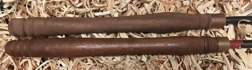

My two favorite gouges are the Jamieson bowl gouge made by thompson and the Jamieson bowl gouge.
I made handles I get a diameter and length I like. Also I like dedicated handles.
I also learned to sharpen handled tools. Last thing I want to do is hold a heavy tool handle filled with lead.
Also a slight advantage is switching between tools with variation in the handles supposedly reduces the risk of repetitive motion ailments.
