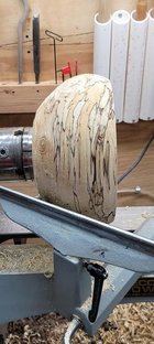

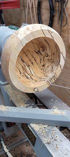

Jay, as some one who uses a recess almost exclusively, the shoulder on that one is too narrow for my taste, especially if you are going to core, and that blank looks big enough that I would core it.

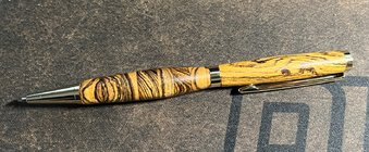

Phil nice bowl and pen. One little tip with the bowl. When it is done you don’t want anybody to know how it was held on the lathe. It would be easy to turn the mortise into a foot.
I agree with you 100% and I am going to attempt my very first coring with this piece. It is still a work in progress. I started the recess before I started the exterior of the bowl and removal of all of the bark. As I was removing the bark a recess was discovered that required that I change the exterior wall shape. Doing so resulted in the recess shoulder being turned away. Still need to turn more on the exterior to remove the entire defect that does not appear in the photo. When I end up with the finished shape I will correct the recess with an appropriately sized shoulder so that my first coring does not end in disaster. Thanks for looking out for me.
Jay
Whereas, I'm happy for anybody to know how I held my pieces on the lathe. I understood back when we were screwing blanks to faceplates to hold them on the lathe why we might want to disguise/turn away those irregular screw holes, but not why anyone would want to disguise or remove a nicely designed recess that was used to hold the piece on the lathe. A tenon with jaw marks, perhaps, but not a nicely proportioned and designed recess... :~}
