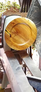

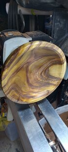

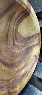

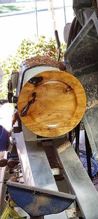

what is wrong with this picture?????
not as irresponsible as it would appear.... handle on toolrest pinch clamp stripped making lathe unusable for anything that required a tool rest - as soon as it happened I got on the phone to Robust and ordered another one.... repair part includes new splined handle and shaft so existing shaft is headed for recycling, so no harm in goobering up the splines with a pair of vice-grips as a 'bubba' handle and at least that way I can use the lathe until the new part gets here - which it did late yesterday afternoon
on the lathe is a green rough shallow-bowl/deep-platter from some kind of pepper tree a neighbor took town as part of a fire insurance inspection of his yard - this was a crotch section with some soft punky spots that will have to be dealt with when it dries and gets re-turned... but the grain and color are just wild - if anything this lighting washes it out some - even green and unfinished it just pops
as an experiment I am putting some of these green bowls under the benches in our sauna un-coated, there is a lot of room under the 2 levels of benches, I heat the space every day to 165 for several hours anyway just to sweat in it, so it is like a 'free' kiln for the wood, it stays > 100F for another 8+ hours and it is very dry, I won't have to worry about really wet wood getting moldy like uncoated bowls can do in the attic -165 temp should keep that from happening... I don't care about cracks as as wood like this is going to crack no matter what and I am used to epoxy repairs on the finish turning - be nice to complete this in a couple of weeks vs a year
Erik, I did that to my AB also, but I used a mini set of vice grips. The teeth on it are an almost identical fit. I have never understood why people make the handle out of soft pot metal, but the threads and head of the bolt are hardened metal. They will fail eventually. I did have a friend make a sliding T handle like you find on vices. I really liked that one. May have to do another one or 5.... The handle is always able to move out of the way.
