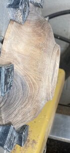

Finished this small walnut bowl, 7" x 2". It had a recess on the bottom I'm trying to decide whether to make it a footed bowl or leave it as is. The pencil line is the depth of the recess. What's everyone think? I've never made a footed bowl and thought this might be an opportunity.
Another nomenclature problem for wood turners (most recent - "jam vs. friction" chucking). Many turners would call this a "footed" bowl as it is. If you are talking about carving away material to get 3-4 small feet I would say no. Not enough material to get a continuous artistic curve. But do it anyway ... good practice for the next one where you plan ahead.
Yes, I'm talking about making it a 3 footed bowl by carving away material.
I am attaching 2 photos of the process I used on an end grain bowl, however the amount of material in the bottom may not be enough to make that continuous curve. The grain orientation appears to be side grain on yours, so you would need to have a balky leg to make up for the weak side grain. The way you are set up you will not need the live center support as shown here, however your setup will not work for a natural edge bowl.
The continuous curve was checked with a profile transfer gauge that easily shows if the curve is continuous on both sides of the leg ring with a small cup center holding the bowl against the jam/friction chuck. On this bowl I marked the locations of the leg by setting the index then made a pencil mark off the tool rest and moving to the next index point, 120 degrees for 3 legs or 90 degrees for 4 legs. The marking jig as shown is used to mark each leg to assure similar contour.
This shows that the contour of the legs was cut close to the lines and then beginning to cut out the material between the legs. The final shaping can be done with files, sand paper, carving knives or whatever works for you.
That shoulder is not strong enough to survive the stresses of turning a bowl that size. You would have to VERY gently turn out the inside of the bowl, and not have even the slightest catch.
I am not sure I understand what shoulder you are talking about.
The post I made was just a methode to carve feet with enough ifs thrown to account for the unknowns. The bowl appears to be done on the inside since it is mounted on the Cole jaws, ready to finish the base.
If there isn't enough material or strength to carve feet then he could easily attach legs such as this photo.24025Bowl4.jpg
