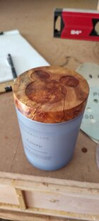

After some great criticism on my project's knob. I carefully remounted it on the lathe and thinned it down. Added a bead in the center also. I think it looks better. Wife was not impressed.
Old:
New:
I'd agree with wife, I like the old one better... new one is just too skinny for its height....
