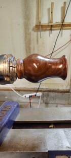

This is my first try at turning Purple Heart. I started out with my gouge, only to find it was blueing the metal. Not wanting to damage my new gouge I pulled out my Hunter carbide. I must say, that cut a lot easier for me, though I just learning the traditional tools.
The Purple Heart sure finished up beautifully.

I understand! Purple heart can be "fun", I've found it varies a lot, perhaps depending on where it grows. I got some supposedly from mexico once that, unlike most, has stayed purple for years. I think the type of finish used helps reduce the effects of oxygen. And keep it out of strong light! That piece is a spindle with multiple applications of shellac (Mylands friction polish). A quick shot on the dining table.
