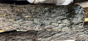

Driving by a house down the road and a ton of sycamore! Owner said take as much as you like. Well I just can't pass up free wood, got to learn to say no. But I didn't as you can see. Ended up with 21 nuggets. Started turning first 2 today. Base of tree is about 5 feet in diameter. Just worked on pieces at road. Had to cut them in half and remove pith they were so large to start with.

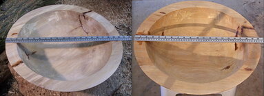

Here are a couple pictures of a Sycamore bowl I turned, 20 inch and rough turned to a 2 inch thick wall.
This shows the 4 inch faceplate and the 1 inch screws I have used numerous times.
This shows the rough turned shape that I turned a recess in to hold it in my Oneway chuck.
This picture shows the new turned bowl and then the fully dry one without any finish on it, you can see the 2 inch wall I used, it shows that I could have gone with a much thinner wall, there is no warping and nearly no shape change.
drying & dry Sycamore bowl.jpg.
Thanks for the tip! How thick would you cut a rough platter, for twice turning? For bowls should I increase the 10% rule?
Well, I turn to final thickness and let them dry and warp. Not sure how to do a twice turned piece with sycamore. I know you can boil it, which generally is 1 hour for each inch of thickness, then let it come back to room temps in the water before removing, then seal and store till dry. Do make sure to round over all edges. The thing I don't like about boiling is that it seems to muddle the colors together. I turn mostly green madrone which warps insanely and it has a lot of color. The sycamore is usually kind of bland, other than the flecking. A quarter sawn piece might be more stable, but I don't really know.
