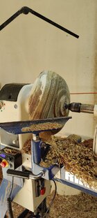

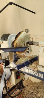

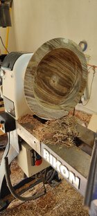

IMG_1058.jpgIMG_1059.jpgIMG_1060.jpgThe center of the tree, in this otherwise clear cherry end grain bowl, was rotten so I am trying an idea to use a 5 ply piece of home made ply wood to fill in the center. The plywood is turned to about 3 3/4" diameter with a slight taper on the fit. The blank is held against a sandpaper faced friction drive mounted in the chuck and the reverse cone in the livecenter.
IMG_1061.jpgIMG_1062.jpgIMG_1063.jpg The first picture shows the plug after being hammered in place. The second picture is beginning to true up the inside. The third shows the fallacy of hammering the plug in place since I obviously did not get it set evenly. The plug was made from 5 ply's just under 1/8" thick, which should prevent any problems with the side grain / end grain joints.
So on the next one I will have to try pressing it in place and have a flat bottom in the bowl or an extra thick outer ply.

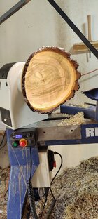

I cut down this walnut tree in April. Other than a couple of pieces from 30' up the tree, I haven't turned any of it. This weekend I got inspired to cut some bowl blanks out of the base of the tree. Here's a live edge bowl in progress. I did soak the bark with CA, but it looked like it was going to stay on pretty well regardless. This section has odd grain and color for walnut.
