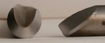

Description from lyle’s web site
FLUTES
This has a better flute configuration—Not a “V”, not a “U” shape—It is 12 inches long with a 7 inch long flute —It has a wider, parabolic flute shape than any other gouge made today—The flute change translates into easier, safer, better control.
couple of screen shots from a demo video that show the flute
Shows the wide round bottom of the flute.

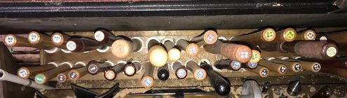

For those of you with multiple bowl gouges in the same size, how do you track how they are each set up? Do you mark them somehow, or do you just simply turn enough to remember how each is set up?
I mark them 2 different ways - Tool ID and Grind ID. I store all my tools handle up, with the steel in a pvc tube. Most all tools have a Tool ID, a 3/4" round adhesive sticker on the end of the handle, printed with my own abbreviations to ID the tool, and different tool types have a different background color:
Grind ID - Bowl and spindle gouges (and a few others) get an adhesive label stuck to the ferrule, and that label is covered with "Super Hold" scotch tape.. I use a Tormek gouge jig, so the info on the label is different, but the same type of info could be used for any sharpening system:
Doug, that is too complicated for me. I use the blue painter's tape and write the platform setting on it..... Plus, I could never figure out how to print all that stuff out onto any type of paper or decal....

I understand, painter’s tape works too! All my years of 5S and continuous improvement in the mfg world makes it very easy for me. While I do have a Crown 1/2” BG, it is labeled 5/8”, the shaft size. The world may not standardize but we can!
