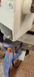

that locking handle for the Vicmarc banjo sometimes gets in the way. Even Woodfast was wise to that problem, and drilled/tapped another hole for the lock down handle.
Yikes. Fortunately cast iron is real easy to drill and tap. (The PM banjo I have came with three tapped holes. Send a note about all these things and tell V to get their act together. :))
I can see the problem with the stop bar. My PM lathe doesn't have a bar but a paddle switch in little magnetic box with a cord long enough to position the switch anywhere reasonable. I usually keep it on the side of the bed a little way to the right of where I usually stand where I can turn it off with my leg if needed. A positionable switch like that might be a reasonable addition for some lathes.
Yeah, but, I've only got one shot at getting the hole drilled perfect, so that it matches the hole in the adaptor sleeve and perfectly aligns with the very center of the tool rest post .
I suppose the only way to do that, is to solidly mount the banjo to my drill press....and, don't even think of trying to do this with a hand held drill.
Any suggestions on how to do this?
Might think of building a onetime-use mount somehow.... ?

Edit: Woah there Nellie........just got an idea.....the light bulb just turned on!!!! :)
Maybe I ought to just get a set screw, or cut down bolt.....and, use the original tapped hole when the handle gets in the way. :)

It's a done deal now. Cutting down a bolt gives me another badly needed inch or so of room.
I built a little kit to install the cutdown bolt. It's made from a temporary wrench and a little tube to store the unused bolt.
It now hangs on the wall behind the lathe:
One more problem solved, but Vicmarc should have taken care of this in the initial design of the banjo.
