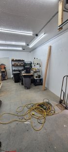

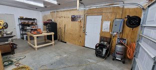

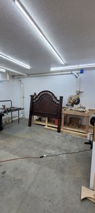

Finished the insulation and vapor barrier. Buddy will come up Wednesday to help install the rest of the OSB.View attachment 52282
main body of my shop is 24 x 36 also, but with a 14' ceiling up to a 12x36' loft with 8' ceiling. Note the bare studs above the 8' level: Most construction projects I have started are never finished. The are simply abandoned when they reach a state of usefulness. Red tractor is long gone

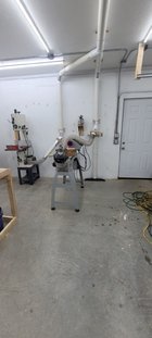

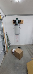

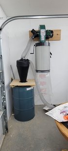

Nothing like a custom sized shop. Curious how your managing dust control, have you designed to have your dust equipment move particulate directly outside of the building?
in the area where I keep my planer, I run it thru my DC blower and run it outside into a pile. The stock Powermatic planer in the photo has been replaced by a Rockwell planer with a helical head. The horse is already out of the barn on breathing dust in the main part of the shop, but when the planer is in use, without dust/shaving extraction, one would be up to their knees in shavings in no timeDSC01496.JPG

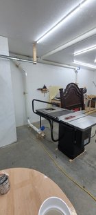

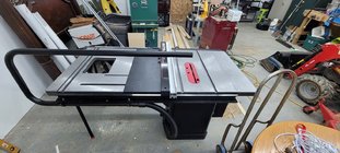

Looking good, Rusty. Might I recommend moving the blast gate on your tablesaw from the floor to the wall to avoid having to bend down - similar to your lathe and bandsaw setup. Are your main lines (ceiling) larger than your drop-downs? ... hard to tell from the photos.
Everything is 4”. The reason I have the blast gate on the floor is so I can separate the table saw from the router table. I need to make one for the router table too but it will be a different size.
Aha! I assume the blue covered Y is for the router table. You can still move the main blast gate to the wall (eliminating the one on the floor) and add another one for the router which will be higher off the floor. Just a suggestion.
I was thinking of leaving the one for the table saw open all the time unless I need to close it for some reason.
Any open gates will reduce airflow and may not allow good function of the system. I always close the not in use gates and only have one in use at a time
