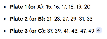

I wanted something easier and more repeatable. An indexing plate solved one issue and a depth stop added to the table dealt with the other. Circled in red here.

Good point here Bill. I invested in the Rotary Table only because everyone said I needed to keep track of the indexing, but then again, that's what an "index" plate is suppose to do. Much easier on the eyes rather than constantly setting and changing micrometer dial reading as found on the Roatary Tables. I'm not sure what the color codes are for on your wheel, but your idea is definitely worth some consideration. Please let me know how this works out in the long run. Attaching below my table that I go by to set my Rotary Table to the correnct number of spaces. Assume your index plate works the same???
The coloured marks are just to keep track of what holes I’m using for a given pattern.
I already had the Indexing plate so it made sense to use it.
