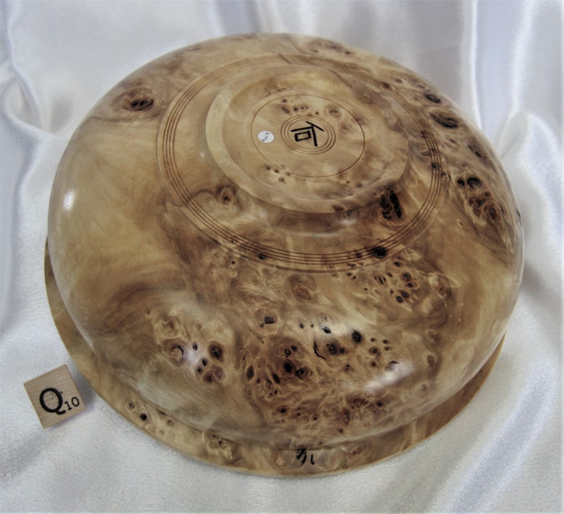

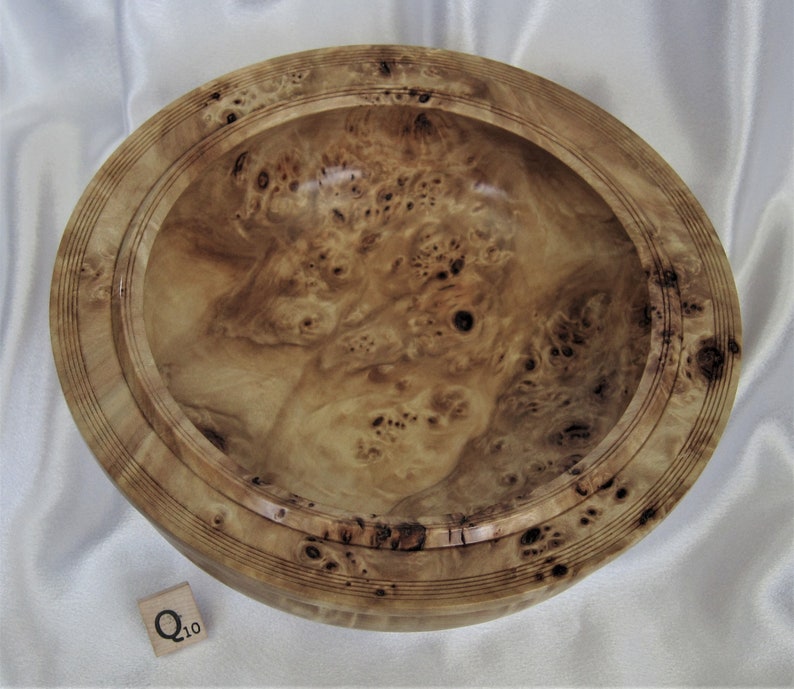

Here's another cottonwood burl bowl I completed recently....also from the west coast:
