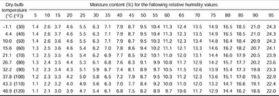

My drying space has a humidity of 50% and a temp of 70-75 so my pieces dry to 9% + a bit.
Find your environments in the chart below to learn how dry you wood can get or how much Mc can increase in its new place
