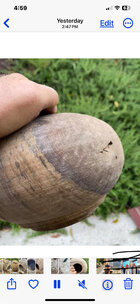

need some advice. Have an 8 inch claro walnut bowl I rough turned which has a defect. I can turn it smaller, leave it as a hole, or fill/highlight with copper powder/epoxy. Thoughts?
Wild grain on that one! It looks like the defect is part of a crack system. If it were me, I would the hole with epoxy and sawdust/bark/coffee grounds, and then put a line of pewa along the crack (including one going through the middle of the epoxy repair).

Good idea. Then I won’t have to make it a smaller diameter and that will add interest. Thanks.
