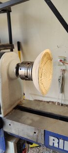

Hickory (I think)? Bowl once turned this morning. 12" x 5.5" in size, one coat of Danish Oil natural. First time trying a bead design.
