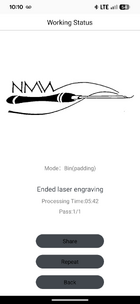

It would have been nice if the app had higher contrast colors that didn't make it nearly impossible to see with the safety glasses on.
I did a screenshot the other day when I was burning some wood nametags for members. It's really tough to read text on the buttons at the bottom.
