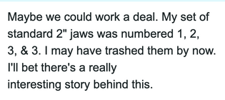

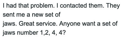

I've seen turners get the chuck jaws mixed up but never with new jaws from the factory. I don't know how they make the jaws now but early on I noted evidence that the jaws appeared to be machined in one piece then cut into four quadrants with a saw - could see the saw marks. That means if, say, a #4 jaw segment from one set was switched with a #4 from another set the jaws may not close properly.

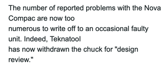

The only Nova chuck that I remember being pulled from the market was their "quick" chuck. They tried to copy the actual "Quick Chuck", and first efforts didn't go well. I do have one of the Easy (?) or Quick chucks, and don't use it. They had problems with their first efforts also. I got the new and improved version. It does work, but every thing I have is geared to my Vicmark chucks so I don't use it much.

Oh, forgot, again..... With the Easy Chuck, the chuck jaws do not have numbers on them. I would think that with all the fancy CNC machines this would not be needed. I did get one extended set of jaws for my bigger Vicmark chuck and one jaw sat back away from the 3 others in closed position. I should have returned it, but it was years ago and I never got "a round 2 it"....
Nova had was Woodcraft selling no name brand inserts for the Nova chucks that made the chucks run out .006 to .009 thousands where Nova was getting blamed for bad chucks.
That was the biggest issue with Nova chucks that I can recall. Fortunately for me I had bought mine before that happened and it only lasted briefly before that was rectified.
