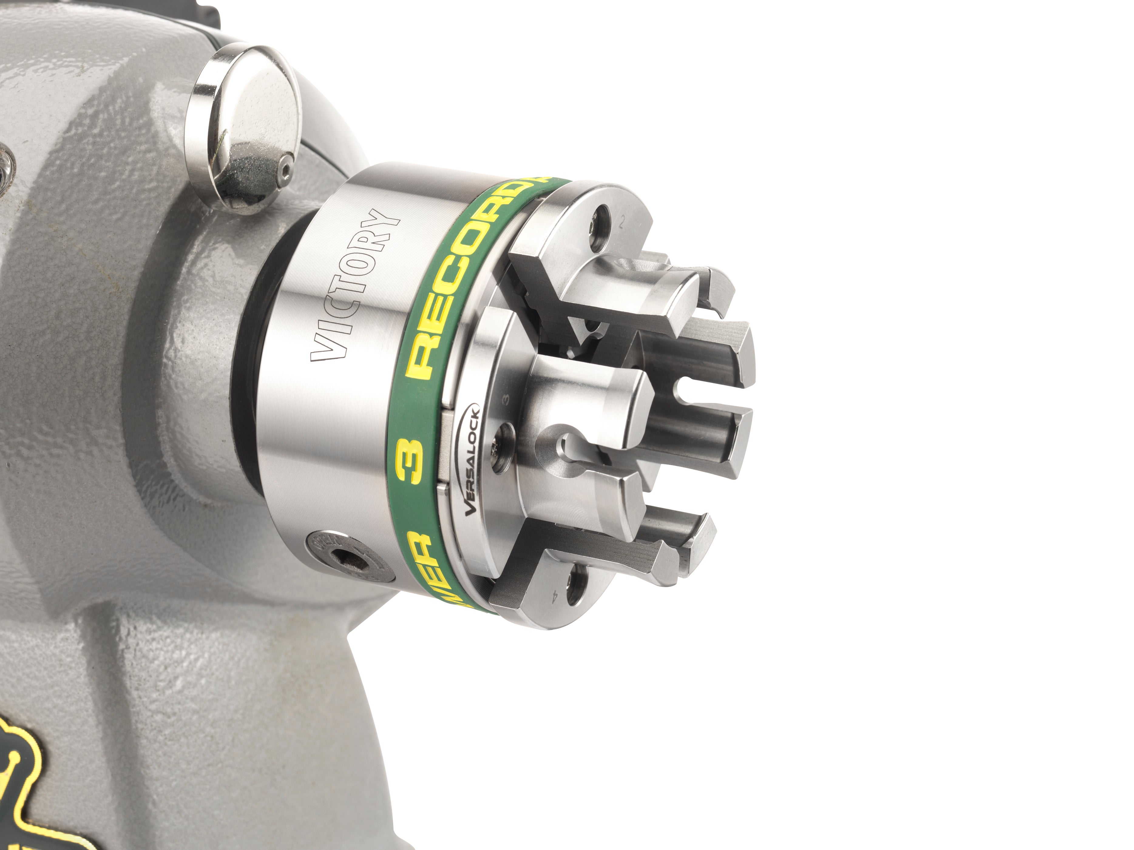

Hi, does anyone know a reputable place state side that sells the record victory chuck? Or if not can you tell me that it's very expensive so I don't need to bother?
I hear the quality concerns. I feel like the bigger quality concerns is me. Still if the price is right Id at least like to check it out.
Thx
We are glad you are here.still a couple I visit and post on
Appears no one has them in stock yet. Turners Warehouse shows an introductory pre-order price of $250 for the chuck and versa loc jaw set. An RP SC4 chuck is ~$200. A Nova SN2 can be purchased for <$200, just shop around. The RP chucks are Nova designs, RP having a licensing agreement with Nova, and I believe RP produces the chucks in the UK. The main difference is wider jaw slides vs Nova chucks. In 6 yrs of use I have not had any jaw slide issues with my Nova chucks, and visual inspection does not show any problems. Several members on here have had Nova chucks for much longer and report no issues. IMO the "wider jaw slides" is a marketing differentiator and not needed.Hi, does anyone know a reputable place state side that sells the record victory chuck? Or if not can you tell me that it's very expensive so I don't need to bother?
Thx
I did a review of the Victory chuck and the Versalock jaw inserts. They do not have a 1"x8 as I originally thought.
