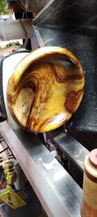

Ok, I'd love to know what kind of wood that is on your lathe. Stunning color and figure. Can't remember ever having a piece of wood that looked like that.
Well this one few apart a few times, I perused it and I think it will be nice when done !
Oh yes it’s cherry !🍒
