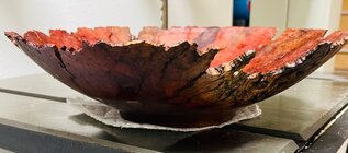

Just took a very challenging piece off lathe. A manzanita burl with cracks and defects. Should have wrapped it because I lost some and had to make it w less height. Still ok. A little more work needed, though. 12 inch diameter. Will take better pictures when it’s done.

How well does a vacuum chuck hold something so out of balance as this?
In this case it held very well. I wasn't sure if the burl would be too porous to get a good vacuum, but it did. The size of the chuck made it almost a jam chuck and I always leave the tailstock up until I remove the nub on the bottom.

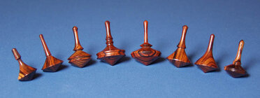

And from the Fidgit Spinner craze: Cocobolo, Ebony, brass
