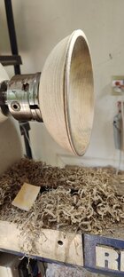

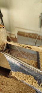

Have you ever tried thin CA? It soaks in well and has stabilized some worthless (but beautiful) wood for me. I like the Parson's 3408.
It usually soaks al the wan to the center but I can reapply if some questionable wood is exposed while turning.

I'll try the CA. The tenon broke off without any pressure on it, so the shellac won't be enough.
