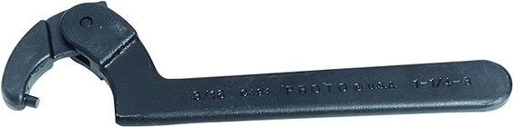

I always use a snap when seating a chuck. That noise and sudden stop lets you know that both surfaces, chuck and spindle are clean and have mated properly. They will run true. A snap on an 8 pound chuck is actually quite a bit of torque, which is why removal can be difficult if you’re not tooled and trained for it.
This is an adjustable pin spanner wrench. It can grab the small hole in the adapter, or hook into the Allen or opening for the chuck key. If it’s really tight, smack the tool with your hand or even a mallet. It’s easy on the tools and is quite effective. Use only for loosening.
We differ in our methods of doing things. I never use a snap anymore. Doing so I have had chucks “stuck”. The reason I quit was advice from the late John Jordan doing a demo at our club. He strongly advised against snapping a chuck. He just did a snug using the key and commented you never need anymore torque to loosen than you did to install. I’ve been doing it that way for several years now and have had no problems or stuck chucks.
Great idea Marc!
I already have one of these spanner wrenches, so the next time I get a stubborn chuck, I'll think of it! :)
